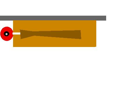

I did something just like this last week. What I did was to stick a 1/4" piece of plywood to the top of the neck with double sided tape. The existing truss rod slot was lined up parallel with the edge of the plywood. The edge of the plywood then ran along the fence of my routher table
Double sided tape is more than strong enough to hold the neck firmly to the board. See crude drawing.

I use a cochran base to install these in the raw stock, so neck stuck to the board trick will work beautifully. I just need to match the centerlines and presto...
